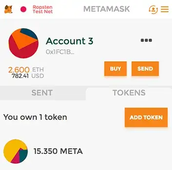

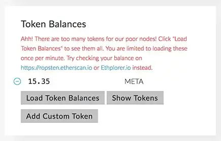

I'm sure it is ERC20 token. Added it to metamask and MEW, both are showing the balance.

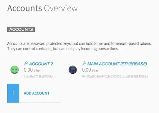

I do see the account though: enter image description here
I think what I may want to do, is to deploy the contract from scratch from Ethereum Wallet, then do the token transfer, then see if it appears on Etherscan.
