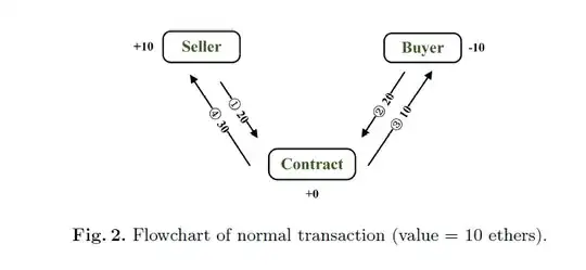

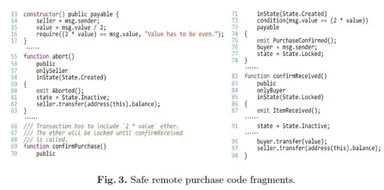

But in this paper, there is an example of a concurrency problem and a race condition in one smart contract by calling two concurrent transactions, creating a race condition, and a kind of attack scenario is introduced. Any idea about the example in this paper, quoted as the following:
"Published on [10], the Safe Remote Purchase smart contract contains 99 lines of source codes and aims to support safe and reliable transaction operation of untrusted buyers and sellers on the decentralized e-commerce platform. For convenience to analyze, in this smart contract we assume that there are only three accounts including the buyer, the seller and the contract where the contract is the third party. We firstly represent value as the price of the item involved in a single order. Then the contract is expected to work as follows. In the constructor function served for initialization, the account who sends the required ethers (2value as the guaranty) to the contract is considered as the seller. If the constructor function executes successfully, the state of the order becomes created. Then the seller waits for the purchase confirmation from buyer. Before the buyer confirms to purchase, the seller has the opportunity to call the abort() function to abort the order, then the guaranty will return to the seller’s account after the state of the order becomes inactive. The account who invokes the confirmPurchase() function is the buyer. As stated in confirmPurchase() function, only if the buyer successfully sends the deposit (2value) to the contract can the state of the order become locked, which finishes the confirmation procedure. The transaction will proceed smoothly until the buyer receives the item. At last, the buyer calls the confirmReceived() function. In this function, the state of the order becomes inactive, then 1value ethers are transferred back to the buyer account, and finally the remaining 3value ethers in the contract account are fully returned to the seller account."
"Figure 2 shows the flowchart of normal transaction described above. From the perspective of sequential programs, the above content is conformed to the expected design purpose of Safe Remote Purchase contract. However, for a concurrent program, the problems of data race may bring about undesired behaviors that can be exploited by adversaries, which is exactly the motivation of this study. As shown in Fig. 3, the vulnerability we have discovered lies in the line order of line 72, which sends Ethers to the contract account, and line 77,which changes the order state into locked. In the course of the executed line 72 and non-executed line 77, the order state is still created. Hence, in this specified period, the seller is allowed to call the abort() function. Once abort() is invoked, the state of the order becomes aborted and the total balance of the contract’s account, containing the guaranty from the seller and the deposit from the buyer, will be transferred to the seller’s account."

  • "In the course of the executed line 72 and non-executed line 77, the order state is still created. Hence, in this specified period, the seller is allowed to call the abort() function." Here they claim the seller can call the abort function, but it's not possible, so all they reasoning falls apart. My guess is that the authors didn't know how ethereum works, and just assumed that concurrency exist. – 0xSanson Mar 05 '24 at 23:14
  • Thanks a lot for your comment, could you please explain more? – Atefeh Mar 07 '24 at 00:17
  • The other answers here already explain it. Every transaction is run atomically in the order is included in the block. You can't run another function in the middle. – 0xSanson Mar 07 '24 at 10:49
