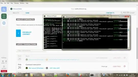

enter image description hereenter image description hereI successfully setup a private blockchain in my laptop and mined around 5160 Ether (no market value). Also deployed a smart contract.

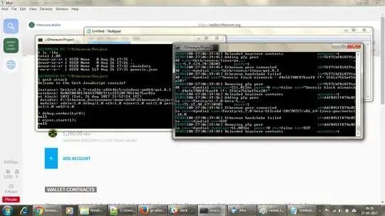

Now I had to close my laptop and when I came back and turned the system on, with all the steps, my wallet on my private block chain is showing 5160 Ethers, but I am not able to mine further and the hash rate is 0.0 KH/s even after miner.start(1); command in geth for around 20 minutes. Where am I going wrong and how to resume mining on my private blockchain? In the first attempt the hash rate was quite decent.
    This seems to be similar to https://ethereum.stackexchange.com/questions/23772/why-does-miner-start-return-null-does-not-start-in-private-testchain?noredirect=1#comment25603_23772 (miner.start() takes a LONG time to start). Can you try debug.verbosity(4);miner.start(1);admin.sleepBlocks(3);miner‌​.stop();debug.verbos‌​ity(3); to help understand what is the matter. Also - do you have just one node running or more than one? – Alan Buxton Aug 26 '17 at 19:05
  • @AlanBuxton Thanks for the debugging steps. I have used them and can see the Ethereum handshake failed due to genesis block mismatch. But the genesis.json is intact and have not been changed. – Mayukh Mukhopadhyay Aug 27 '17 at 01:13
  • Are you sure that you are using the right --datadir dirname param when starting your geth node this time round? If you are using different directory name (or none at all) then you could be accidentally using a directory that uses a different genesis.json. The genesis.json is only used when initialising the node - it's not relevant at startup time. – Alan Buxton Aug 27 '17 at 13:45
