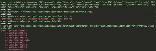

Those are commands that work on the truffle console with testrpc, but now I'm trying to issue those commands through geth to the ropsten testnet.
I've tried to adapt them to this purpose according to the answer to this question, like so:
var contractAbi = eth.contract([{"constant":false,"inputs":[{"name":"count","type":"uint256"}],"name":"increment","outputs":[],"payable":false,"type":"function"},{"constant":true,"inputs":[],"name":"getIteration","outputs":[{"name":"","type":"uint256"}],"payable":false,"type":"function"},{"inputs":[],"payable":false,"type":"constructor"}]);
var myContract = contractAbi.at(0x8705C513da621a16fd1dEFc9dE8aE7CDEAD01Fb8);
var getData = myContract.getIteration.getData(1);
web3.eth.sendTransaction({to:0x8705C513da621a16fd1dEFc9dE8aE7CDEAD01Fb8, from:0xd7a9a61a480d458a1181e0563b07f944df4489a6, data: getData});
but it didn't work, the result was this:
Error: invalid address
    at web3.js:3879:15
    at web3.js:3705:20
    at web3.js:4948:28
    at map (<native code>)
    at web3.js:4947:12
    at web3.js:4973:18
    at web3.js:4998:23
    at <anonymous>:1:1
The output of getData rendered in this way:
> getData
"0xfc2c3e08"
See the console output here:
What is the correct procedure to adapt those commands to execute a function on the ropsten tesnet using geth console?

It seems to work if you put the addresses in quotes:
undefined
> var myContract = contractAbi.at("0x8705C513da621a16fd1dEFc9dE8aE7CDEAD01Fb8");
undefined
undefined

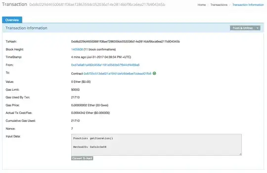

web3.eth.sendTransaction({to:"0x8705C513da621a16fd1dEFc9dE8aE7CDEAD01Fb8", from:"0xd7a9a61a480d458a1181e0563b07f944df4489a6", data: getData});
"0xb8d229d46500681f08ae7286359dc052036d14e2814bbf9bca6ea217b904345b"
and so I guess the result of the transaction is here on etherscan.io:
It says that I called the function getIteration(), and it's true, I did do that.
