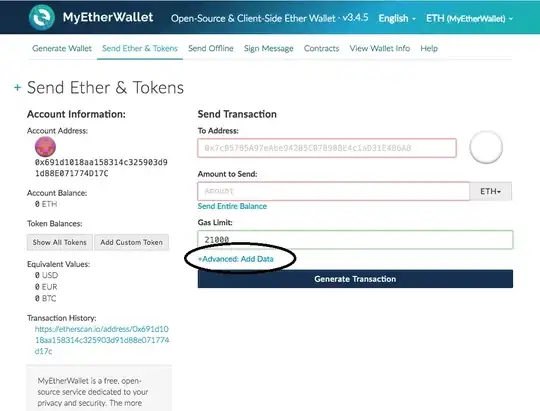

In myetherwallet, there is an +Advanced: Add Data Section where I can add data to the transaction.
How can I add this same data in a transaction I make in Solidity?

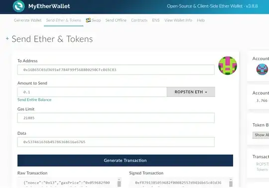

you need first to convert your string to the hexadecimal form using an online converter like http://string-functions.com/string-hex.aspx.
then put it in the data field (with 0x in the begining)
for example i've converted StackExchange into 0x537461636b45786368616e6765

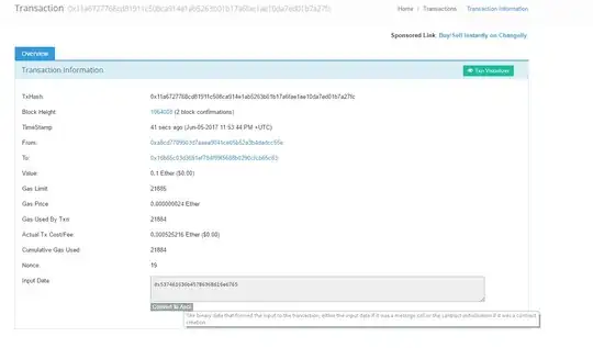

put it in the data field and then i've send successfully my transaction. you could check the transaction here.
you could press the convert to asci button in the bottom to get back the encoded sent string.
