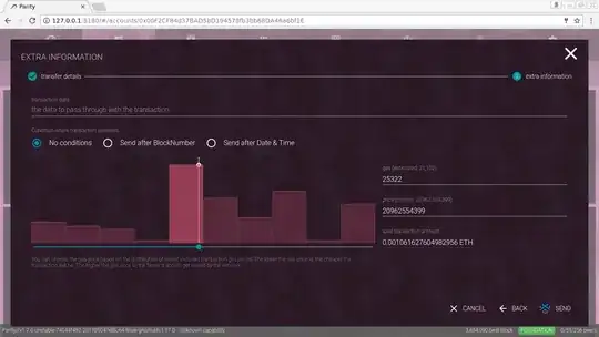

Just schedule it with the wallet user interface.
accounts transaction 1
Create any transaction you like, make sure you select "advanced settings" and determine the condition to be either:
  • send after block number
  • send after date and time
Parity will hold this transaction back until the condition is met. Note, for this your node needs to keep running.

  • Great! Will I be able to sign the transaction before scheduling it or will it prompt me to do so when the block height is reached? – Youssef May 24 '17 at 19:03
    You will sing it immediately, but it withholds the transaction from broadcasting until the time or block condition is met. – q9f May 24 '17 at 22:12

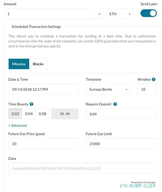

It's quite easy to do using Ethereum Alarm Clock, which has been deployed to mainnet and since then working perfectly. 100% transactions have been executed so far.
You can schedule a transaction for specific block/time using following ways:
  1. Use MyCrypto (toggle "Send Later" button) - here's helpful tutorial.
MyCrypto interface for scheduling
  1. Use Ethereum Alarm Clock DAPP
Both ways are equally good.
About the protocol itself - it has been security audited. There was more than 1000 ETH already moved through the protocol.
Ethereum Alarm Clock is decentralized and automatic. It's currently the best way to schedule a transaction and is not subject to problems that solutions posted in other answers are.
