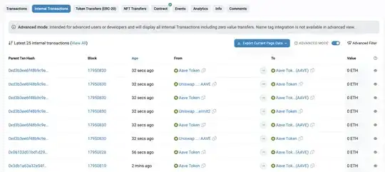

One of the easist ways to get a list of transactions (and internal transactions) is to use a block explorer like etherscan.
For our Aave token, it's very easy to see a list of transactions. And if we select internal and toggle onadvanced we can see a list of contracts that have interacted with Etherscan.
On Etherscan's back end, they are indexing all this data for us, so we can "see" it easier.
They also have an advanced filtered mode, but getting exactly what you want can be a little tricky.

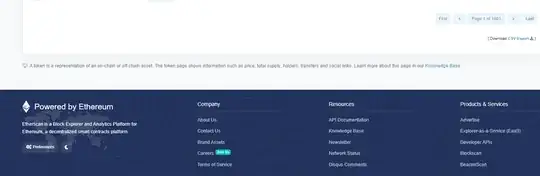

The answer is rather simple. I also tried to solve this by coding my way through it. Etherscan has a feature allowing you to download all the transactions as a csv file. At the bottom of the page: Download CSV Export
