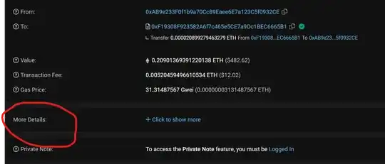

  1. And when I click on the Transaction hash, I see this :- and on there I can see a clickable link called 'More Details' :-
More Details

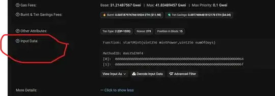

  1. When I click on '+ Click to Show More' I can see a field called 'Input Data' :-
  1. There are always and only 2 Hexadecimal data that appear in this field :-
(a) Mint Power [0] (b) Number of Days 1

Sorry for not answering directly to your reply because I do not have enough points. I believe the error comes from the transaction input. You may parse the wrong one.
It would be great if you can print the "inputs". If you parse correctly, the value of inputs should be something like this (according to this transaction https://etherscan.io/tx/0x958ccfe41ea002afe69234aa10a106ba5e87d6807ccaf6b3a23a5826bfc1399f):
Hope it helps you.
