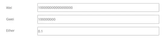

yes, you used the ether keyword with a floating point correctly. In Remix your 0.1 ether line didn't cause any warnings or errors.
If you create a test function that returns 0.1 ether, you can see that it really returns 100000000000000000:
function test() public pure returns(uint){
return 0.1 ether;
If you put this WEI value into an Ethereum unit converter, you can see the number's equivalent in GWEI and ETH:
