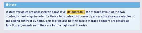

The critical thing to know about delegate call is how storage is written.
The behaviour of the function you call will mimic everything including the storage variables are stored at. If the contract you mimic stores B at slot 3, then slot 3 will be used in your contract no matter the variable name. It is critical to know and and act carefully.
In the MainContract that is delegating from OtherContract you have a big storage problem.

  • Okay so, correct me if im wrong, although I don't have any variable names for storage slot greater than 2 (only having 1 state variable in MainContract) because in my 2nd contract that im making a delegatecall to, the storage slots in my original contract are updated based off any updates to the corresponding storage slots in OtherContract made in the delegatecall function, right? In OtherContract's case it would be slots 1,2 (users and totalUsers respectively)? – pierre96 Sep 09 '23 at 02:19
  • Sorry I've read it 5 times but I don't understand your question. Basically after the first call it will stop working since the first variable address public otherContract; will be overriden by the struct's pointer. If the storage layout of your two contracts are not the same, then there will be storage slot collision and overriding. – Torof Sep 09 '23 at 07:13
  • One work around is to predefine at what slots the variable will be saved, using yul. The diamond storage pattern from the ERC2535 uses this. – Torof Sep 09 '23 at 07:15
  • Apologies, what i was trying to say, OtherContract has 2 state variables, users and totalUsers (slot 1 and 2 respectively). MainContract only has 1 being otherContract and after the delegatecall, slot 1 and 2 for MainContract, will be overwritten by users and totalUsers? – pierre96 Sep 10 '23 at 08:09
  • something like this. users is a mapping so it doesn't use only 1 storage slot.
    In Solidity, mappings are stored in storage slots in a way that is different from arrays. Arrays are stored sequentially, starting from the first storage slot, while mappings are stored using a hash function. The hash function takes the key of the mapping element as input and produces a 256-bit hash value. This hash value is then used to calculate the storage slot index of the mapping element.
    Please look at the layout in the links I provided in my answer.
    – Torof Sep 10 '23 at 08:17
  • Got it, thanks! I don't think delegatecall will work the way i'm thinking of designing my project. If I have a main contract that interacts with multiple other contracts it will get too hectic. For the time being I'm just changing my implementation to use tx.origin instead of msg.sender. – pierre96 Sep 10 '23 at 08:33
  • I woukd not advise so if you don't know what you are doing. there can be issues with using tx.origin instead of msg.sender. Why don't you just call the other contracts with a normal call or use the proxy pattern ? If my answers were helpful to you please upvote and accept my answer. – Torof Sep 10 '23 at 11:08
