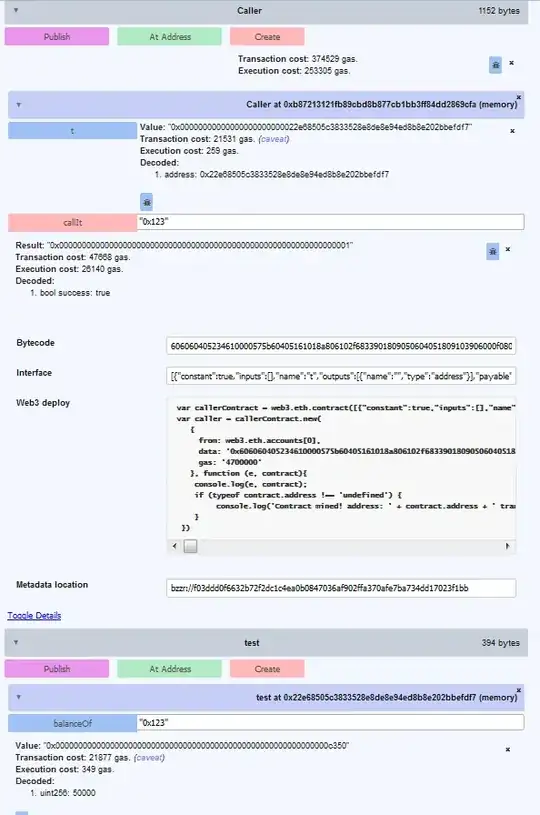

Try this. Deploy the caller, and it will deploy the test contract to simplify matters.

In Remix to show it working.

  • The example you displayed seems to be the 2 contracts in the same deployed address right? In my case the Contract A and B are deployed in different addresses (I updated the description with contract A and B). Do you know how to make it work when the contracts are deployed in different addresses? – Resten Apr 19 '17 at 13:19
    No. Two contracts at one address is not possible. Two contracts in a single source file, with the first contract deploying an instance of the other (one way for it to know the address of the other). Caller at 0xb872, test at 0x22e6.t = new test(); deploys a new instance of test. For already deployed test{} you can pass in the address or hard code the address. Caller will need to know it to make the call. The single source file gives the compiler a view of the test contract so it) understands the test{} interface and has the bytecode it needs to deploy a new test{}. – Rob Hitchens Apr 19 '17 at 14:33
