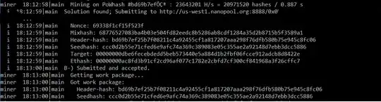

I've just started mining with a gtx 1070, and following a guide on the web I've set everything up, using a pool (nanopool). Watching the result of the mining program I noticed alread 3 times that I found a solution, here is the screenshot:
So that means that my GPU found the solution of the block? It's strange to me to get 3 solution (should be 15 ether reward right?) in 30 minutes, it would be way too lucky imo.. Or am I missing something?
Also if I would like to mining in solo instead of pool, how should I set my ethminer command line?

This is because you are mining as part of a pool (nanopool), with that being said, any blocks found by the pool are mined collectively and the reward (5 ETH for a block + transaction fees or uncles) is distributed or shared amongst pool miners proportional to the hashing power contributed by each miner. The solutions you find are part of a bigger solution.
When solo mining however, you would get the whole reward (5 ETH for a block + transaction fees or uncles). I hope this helps.
The key is : difference between Pool and Solo mining.

You found a solution to a given pool share not a full block.
If you were solo it would mean a block.
It doesn't.
Just a completed share for the pool that gave it to you.
Miner doesn't know the difference or care.

With the current difficulty of finding a solution this question answers itself. No way you are finding blocks there.
