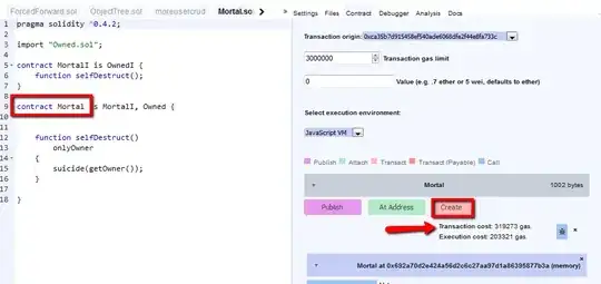

    @DakotaQuint What Tjaden said, or drop the source code into Remix and see what it estimates. Either will work. In any case, out-of-gas may be misleading. If there is a problem with the contract deployment then no amount of gas will suffice, so pointing this out for you. Not trying to confuse the issue. – Rob Hitchens Apr 12 '17 at 13:20
One online tool (no syncing, no installing) is Remix a.k.a. Browser Solidity.
https://ethereum.github.io/browser-solidity
In screen shot below, a trivial contract called "Mortal" cost 319,273 gas to deploy.
Hope it helps.

  • But my contract includes other small contract, and other contracts that I have installed through npm. Looks like Remix doesn't useful in this case. – hqt Apr 28 '18 at 21:41
  • Thanks @Rob This is helpful. How can we do this programatically? – Tomiwa May 26 '22 at 17:26
  • There are several platforms you might use. Hardhat is purpose-built for testing and deploying contracts. There's also truffle. Both let you script out deployment processes in JavaScript. (Over-simplifying) npx hardhat deploy --network kovan – Rob Hitchens May 27 '22 at 15:50
