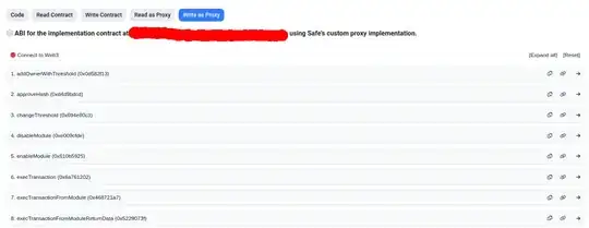

There are couple ways you can call execTransaction on your safe contract. One easy way is to open your safe contract on the appropriate web-based blockchain explorer (e.g. ftmscan, etherscan) enter image description here
Then you would click "Connect to Web3" (see red circle at top of image), connect your Metamask wallet, and manually enter the transaction values under "Write as Proxy". In this case I want to send 1 FTM from my safe contract to some arbitrary address.
Click 'Write', approve the transaction in Metamask, and it will execute.
To send a non-native token, you would need to change the data and to fields and also set the value field to zero when you call getTransactionHash and execTransaction. You can get the correct data and to fields by setting up the transaction in your safe for an arbitrary non-native token, then seeing what the values for those fields are in the Metamask window (without actually signing the request).
To go even further, another way you can call execTransaction is with python. In this case you would cut out Metamask. Notice in the first screenshot where it says "ABI for the implementation contract at ...". You'd go to that contract to get the ABI and bytecode for your safe, and then call execTransaction using the same data as was entered using the block explorer UI.
