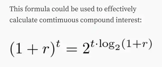

I tried using the ABDKMath64x64 library and using this formula: enter image description here
