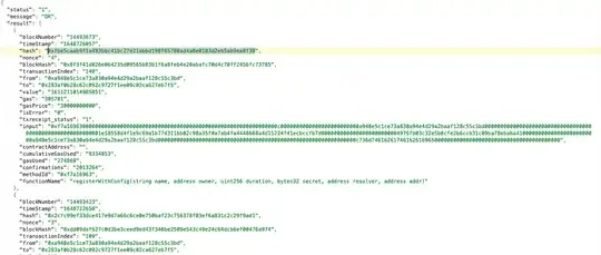

I'm trying to find a way to get the public key of an Ethereum's address. I found out that if an address has an outgoing transaction it's possible. I used Etherscan's "txlist" to get the address transactions, it would output something like this:

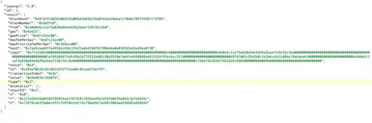

And then from the "hash" parameter I used Etherscan's "eth_getTransactionByHash" to get more information about the transaction and get v, r, and s. The output would be something like this:
