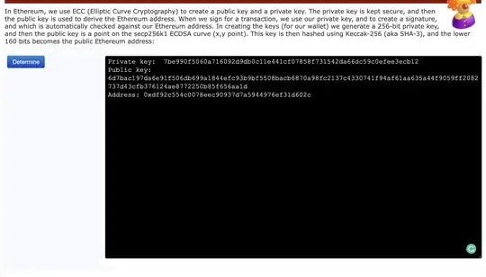

The public key in question was generated from this page: Ethereum Address Generator (Been using it for years to get some test addresses etc.)
Generate ETH address
So I hard-coded the publicKey I got from there to test my simple contract.
However the address I got is 0x70191eCc889463533ea48C3A666e7eE0692a0087 while the Ethereum Address Generator returns 0xdf92c554c0078eec90937d7a5944976ef31d602c as valid address (For the same public key)
Basically, I get different address for identical publicKey and I would like to understand what am I doing wrong.
