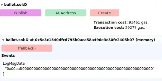

Here is a "proof" to try in Remix:
contract C {
    // in Remix, pass bytes as an array like: // ["0x00","0xaa", "0xff"]
    function test(address addressOfD, bytes bb) {
        addressOfD.call(bb);
contract D {
    event LogMsgData(bytes calldata);
    function() {
        LogMsgData(msg.data);
