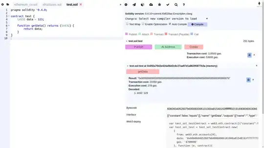

When I'm calling getData() with JS virtual machine, it works fine:
remix

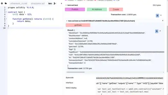

But with selected Inject web3 (Metamask) it returns information about new transaction, instead of 123
remix_web3

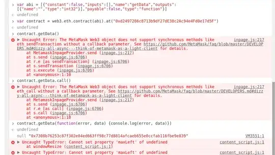

I also can't receive any data from the JS console (Metamask):
eth

    The last example in the JS console looks like it should work. Maybe this question needs to focus on that part. – eth Apr 05 '17 at 23:43
  • @eth Yep, it works fine, but I get txn hash instead of 123, as expected – Sergey Potekhin Apr 05 '17 at 23:47
    Sorry, I misread the console output as error being undefined and data as null. The txn hash is returned because a transaction was issued by web3 instead of a "call" (hope you saw the question that asks about the difference). – eth Apr 06 '17 at 04:28
For the question, the simplest is to make getData constant as:
function getData() constant returns (int32)
Another option is to use an event: How to get return values when function with argument is called?
