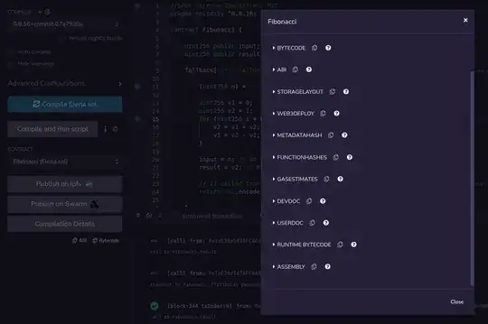

    return abi.encode(v2);
Compile it (maybe with Remix), take the runtime bytecode, and submit it. In my case, it's:
608060405234801561001057600080fd5b506004361061003a5760003560e01c806365372147146100df578063eaed3f4f146100fd5761003b565b5b6000366060600083838101906100519190610162565b90506000806001905060005b60018461006a91906101be565b8110156100a057818361007d91906101f2565b9150828261008b91906101be565b9250808061009890610226565b91505061005d565b508260008190555080600181905550806040516020016100c0919061027d565b6040516020818303038152906040529350505050915050805190602001f35b6100e761011b565b6040516100f4919061027d565b60405180910390f35b610105610121565b604051610112919061027d565b60405180910390f35b60015481565b60005481565b600080fd5b6000819050919050565b61013f8161012c565b811461014a57600080fd5b50565b60008135905061015c81610136565b92915050565b60006020828403121561017857610177610127565b5b60006101868482850161014d565b91505092915050565b7f4e487b7100000000000000000000000000000000000000000000000000000000600052601160045260246000fd5b60006101c98261012c565b91506101d48361012c565b92508282039050818111156101ec576101eb61018f565b5b92915050565b60006101fd8261012c565b91506102088361012c565b92508282019050808211156102205761021f61018f565b5b92915050565b60006102318261012c565b91507fffffffffffffffffffffffffffffffffffffffffffffffffffffffffffffffff82036102635761026261018f565b5b600182019050919050565b6102778161012c565b82525050565b6000602082019050610292600083018461026e565b9291505056fea26469706673582212200a07d1acb375662d0b29a5f80dc05e9effdf73118008d05c193b7417094b1c8064736f6c63430008100033 In Remix, click on Compilation Details and click on Runtime Bytecode:
And get it:
