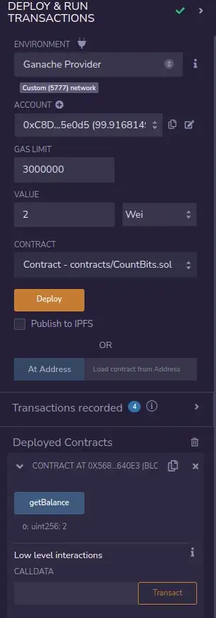

To call a fallback function of a smart contract that is loaded in Remix, you just need to click on the "Transact" button:
// SPDX-License-Identifier: MIT
pragma solidity ^0.8.16;
contract Contract {
fallback() external payable {
    // Do something or nothing and receive the eth sent to this contract
function getBalance() public view returns(uint256) {
    return address(this).balance;
Select some eth from the "Value" input box, and then click on "Transact" button at the bottom:
It's optional to specify any data.
You cannot call a payable function without sending some eth. When you call the fallback() external payable or receive() external payable function will accept the ether automatically. If you want to keep track in the smart contract of who has sent you some eth, you could create a mapping(address => uint256) public balances and save something like this: balances[msg.sender] += msg.value;. But either if you keep track of the deposits in the balances mapping, the smart contract's address itself is the one with the eth funds in the blockchain and only the smart contract can spend it (if it has logic to do so), sending eth to some other contract's address or any other address.
When you call a smart contract without specifying any data (no specific function to call), or the data does not match any function in the smart contract, then the fallback() external function will be called. The fallback() external function must be external, but payable its optional for it.
