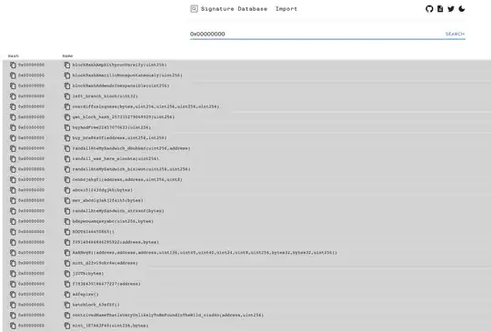

Which leads to the second answer. Which is that if there is a deliberate attempt to create a collision, it is easy to do so. e.g. by building interfaces out of functions with 0 valued selectors, as can be found in online signature databases signature database screenshot of 0x00000000 selector functions https://openchain.xyz/signatures?query=0x00000000
This is because 0 ^ x = x. Probably you should be suspicious if someone is deliberately crafting collisions, as to what their motives might be.
