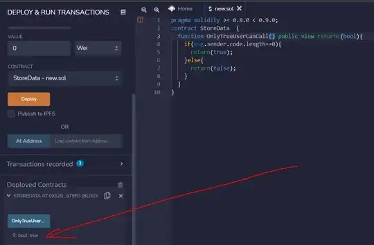

If you want to limit the access of functions in your Smart contract to only normal user addresses.
Insert this in 1st line of your function:
require(msg.sender.code.length == 0, "Only normal user allowed, Smart Contracts not allowed");
msg.sender return the Address of the one who call the function
0xAddress.code return ByteCode of any address. Which is nothing for normal user Address.
e.g. if OnlyTrueUsersCanCall() function will be called, it would return true for normal users, and false for bots/SmartContracts. In true part, you can include further steps.
pragma solidity >= 0.8.0 < 0.9.0;
contract StoreData  {
  function OnlyTrueUserCanCall() public view returns(bool){
    if(msg.sender.code.length==0){
      return(true);
      // do your stuff here
    }else{
      return(false);
    //in case of bot or smart conract call the function
Solidity Bots can not call the function
aakash4dev
  • 691
    As @ikijong explained, this won't work as you could just call the contract in the constructor arguments (while the contract code length is 0) – Enzo Jul 10 '22 at 08:19
  • what does that means ? are you saing that msg.sender can be only call in constructor() ? – aakash4dev Jul 10 '22 at 08:31
  • This code.length function can be forged by putting the code you want in the constructor of the contract calling the StoreData contract. There is more information provided by @ikijong in his answer. – Enzo Jul 10 '22 at 09:13
