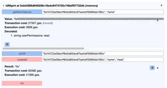

I have written some Solidity code, with a setter method createId to write a name-value pair to contract storage, and a getter method getPermissions to get the value associated with a particular name. It works correctly in browser-solidity (In screenshot below, createId was called before getPermissions).(attached screenshot)

To test whether it is just the eth_getCode not working correctly, I used the JSON RPC API eth_call to call the setter (which has no return value) to set a value, but calling the getter returns an empty result, too. The screenshot shows that the correct value was returned by the getter in browser-solidity.
