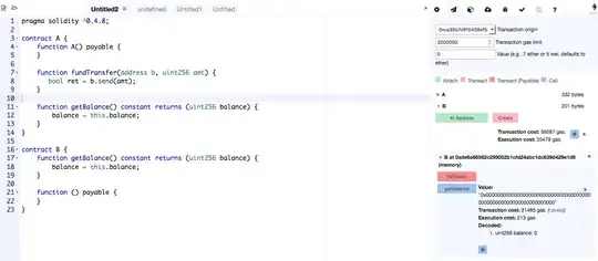

The first screen below shows the deployment of contract B to the address 0xde6a66562c299052b1cfd24abc1dc639d429e1d6. Note that Value is set to 0.

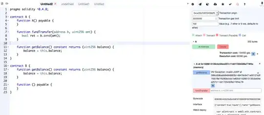

In the next screen, I have set Value to 100 (ethers) and deployed contract A. Note that A.getBalance() returns an error - this is because a value of 100 ethers is sent when invoking A.getBalance() and this function is not marked with the payable modifier.

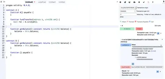

In the next screen, I will execute A.fundTransfer(...) with the parameters "0xde6a66562c299052b1cfd24abc1dc639d429e1d6","50000000000000000000". Note that the "50000000000000000000" number will need to be quoted or the number will cause an error.
And the next screen shows the successful transfer of 50 ethers from A to B. You can also check that A.getBalance() returns a value of 50 ethers.
