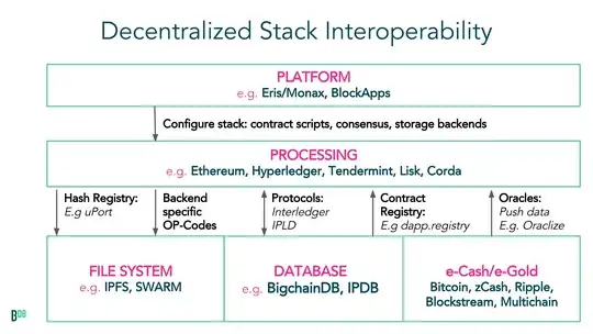

In the Blockchain Stack it suggests that the Ethereum "decentralized processing" is above the File System and BigchainDB.
At BigchainDB we believe that each technology serves its purpose. In typical web-application stacks, some technologies are better at processing (eg. Amazon EC2) than data querying (eg. MongoDB). For developers it should feel natural to map a similar stack to the decentralized paradigm.
Here is an example how that could look like.
__________________________________________________________________
|                       Application: DApp                         |
___________________________________________________________________
|               Processing: Ethereum, Hyperledger, ...            |
|   File Storage:  |       Database:       |    e-cash/e-gold:    |
| IPFS, Swarm, ... | BigchainDB, IPDB, ... | Bitcoin, Ripple, ... |
