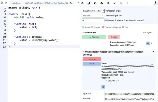

Here's a simple example to demonstrate casting msg.value to a uint248 value using Browser Solidity with the following code:
pragma solidity ^0.4.8;
contract Test {
    uint248 public value;
    function Test() {
        value = 123;
    function () payable {
        value = uint248(msg.value);
The screen below shows the deployment of the code to the JavaScript VM:
I've set the Value field to 456.789 and clicked on the (fallback) function, simulating the sending of 456.789 ETH to the contract:
I've set the Value field back to 0 and clicked on the value button to show that the msg.value of 456.789 ETH was casted to a uint248 field:
