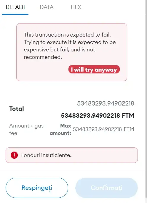

The contract gets called and metamask is opening the transaction, but the price to pay is HUGE, please see the screenshot below. I am connected to the fantom test network, but replicated this in Rinkeby as well.
I do not understand what I am doing wrong here...

The issue here is that the code you had mentioned is trying to approve from the contract's address.
token.approve(address(this), _tokenamount);
Approve function in ERC approves Approvetokens functions, it'll call the approve function in the ERC20 contract. For that call, msg.sender will be your contarct, not you. Since the contract doesn't have sufficient balance, it'll fail with Insufficient balance.
To approve your contract to spend your tokens, you'll need to call the token's approve function from your address. Hope this clarifies your question.

  • Oh, I thought that address(this) will take the address of the submitter. That makes sense. I will re-try and come back if any questions. Thank you :) – FBK Jan 27 '22 at 08:36
