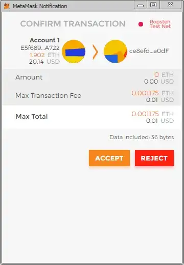

Trying to call sendFundsToFriend() method on the testnet contract https://testnet.etherscan.io/address/0xce8efd03766a309af57ddeb9c79f3e7cd23da0df (contract code at https://gist.github.com/anonymous/5bdc3d9032a8b3cb5cba7c7625afa4d7 ) I got:
Warning! Error encountered during contract execution [Out of gas]

When sending the tx, Transaction gas limit is set to 3000000, the default browser-solidity value.
If tx cost is 58787 gas and the limit is 3000000, why the out of gas error? Any idea? Thx!

  • Unfortunately, it doesn't work this way either: https://testnet.etherscan.io/tx/0x133489c66841cdc9107ac0049687193940f1d8727c267ee5f60911077fbdbf04 In this case, destination address is https://testnet.etherscan.io/address/0xa7e3c7c227c72a60e5a2f9912448fb1c21078769 having several previous txs and a not null balance. This same tx using geth node works ok from a geth node => https://testnet.etherscan.io/tx/0xc719dbf19d57eca5bc9d2ff88fdc9e6918bf2bab4b6b585c1dcb3fe8ece97cb4 – Juan Ignacio Pérez Sacristán Feb 07 '17 at 00:30
    Looking closely, it seems that metamask sends exactly enough gas, whereas geth sends extra gas. I'm not sure why it would break if it has just enough--there's a small number of obscure possibilities. (I don't think it's a refund issue, since there's no storage deletion or selfdestructs.) – Matthew Schmidt Feb 07 '17 at 14:49
  • gas sent by metamask:
    33787 on https://testnet.etherscan.io/tx/0x133489c66841cdc9107ac0049687193940f1d8727c267ee5f60911077fbdbf04 58787 on https://testnet.etherscan.io/tx/0x703d7657c093557d1cd42dfeb7b8d0d3b74e413d22e8009b26d7ac966c85d048 and https://testnet.etherscan.io/tx/0x5dde4e0536756b380b34a6fed79bda50bbe274c25b07ac1812f0d816917b9fbd
    while geth is sending 1000000 but spending just 23263 => https://testnet.etherscan.io/tx/0xe925db662523e74f587b0eb7107c1823da213b1bedfb1279ac3a7fb4dbcd80b5
    – Juan Ignacio Pérez Sacristán Feb 07 '17 at 17:17
    I still can't think of it being anything but not having quite enough gas, since the transactions are identical otherwise. What client sent it shouldn't matter, as it's miners that execute it. – Matthew Schmidt Feb 07 '17 at 20:06
    Or not!? See my latest edit. – Matthew Schmidt Feb 07 '17 at 20:25
  • Thanks Matthew. A bug with metamask is my hypothesis too. – Juan Ignacio Pérez Sacristán Feb 08 '17 at 08:58
