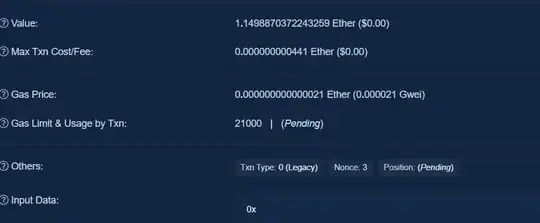

  • I thought it was working but the transaction is stuck pending, I went to see the transaction and the gas price seems to be too low and is stuck in pending. I will update the post with the screenshot of the transaction – Little Ball Dec 29 '21 at 18:05
  • It's pending, because you haven't updated the transaction object as it should. Look at your screenshot, the transaction is signed with 0.000021 gwei which means this transaction will be stucked forever until you resubmit it with higher gas price and the same nonce as the stucked transaction. In the transaction object the gasPrice property has to be the outcome of await web3.eth.getGasPrice() as it's shown in my example. – Miroslav Nedelchev Dec 29 '21 at 18:40
