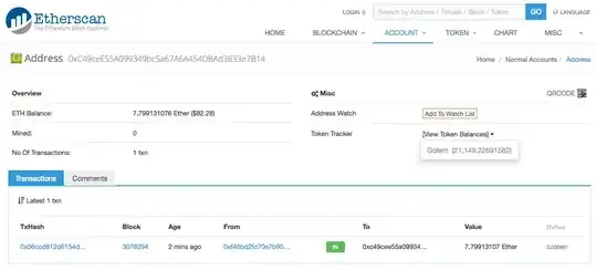

  1. Navigate to https://etherscan.io/ . Enter the account in the search box on the top right, the click Go. If there are tokens associated with the account, you will see the Token Tracker dropdow. Clicking this will show you the number of tokens owned by the account. For example: https://etherscan.io/address/0xc49cee55a099349bc5a67a6a454dbad3833e7b14 :

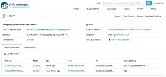

  1. If you know the token, navigate to https://etherscan.io/ . Select the menu Token -> View Tokens. Then select the token in the list. In this example, we will look at Golem. Enter the address of interest in the Filter By Address field and click Apply. The following screen shows the details for the same address in the example above:
