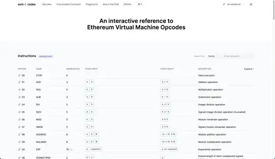

There are lots of reference websites for EVM opcodes:
- crytic's evm-opcodes repo
- ethereum.org
- ethervm.io
- evm.codes
My favorite one is evm.codes:
