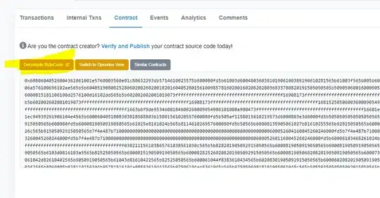

If you go here: https://bscscan.com/address/0x890308ccaeb490a536ee70230f9183524b17f082#code You'll see a button to decompile the contract: enter image description here

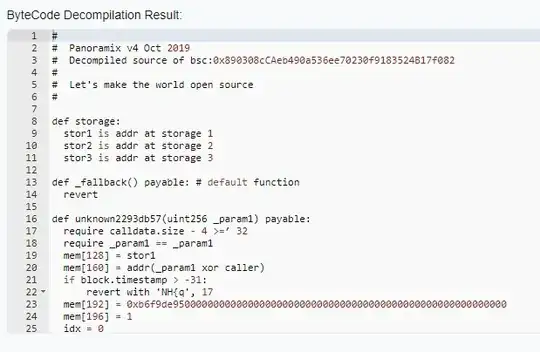

It seems like you can work out the abi from the result: enter image description here
