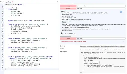

Browser Solidity - Deploy And Execute add_user(...)
Browser Solidity - Attempt To Execute remove(...)
When attempting to execute remove(...) in Browser Solidity, the message callback contain no result Error: Intrinsic gas too low is displayed.

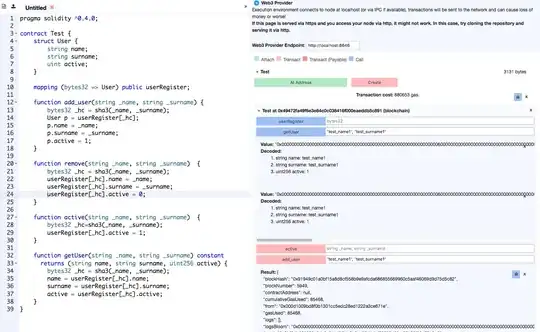

If I modify remove(...) to add the following:
function remove(string _name, string _surname)  {
    bytes32 _hc = sha3(_name, _surname);
    userRegister[_hc].name = _name;
    userRegister[_hc].surname = _surname;
    userRegister[_hc].active = 0;
I am able to execute the function in Browser Solidity, but the returned from getUser(...) shows that the value of active is not modified from 1 to 0.
Executing The Modified remove(...) function in Browser Solidity
The following screen shows the remove(...) function being successfully executed in Browser Solidity:

The following screen shows the second invocation of getUser(...) where the results are unchanged. active is still 1 instead of the expected 0:
