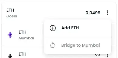

I was stumped by this too, but then found that you can bridge on OpenSea from the Goerli ETH to Poly ETH. You can get Goerli ETH on several test faucets (like on Chainlink). In OpenSea testnets, you can then click on the wallet icon, click on the dots to get the option to 'Bridge to Mumbai'.

Obviously I can use Mumbai Matic only to deploy the contract and to mint NFTs. But I cannot use Mumbai Matic for trades on the OpenSea test network. I could offer an NFT without problems (offering an NFT does not cost anything). But I could not buy this NFT using a second account. Neither with Rinkeby Ether nor with Mumbai Matic. Mumbai Matics contained in Metamask will not be listed in Opensea as currency usable for trades.
Then I got Göerli Ether from a faucet like described by Sylvia. In Opensea this Göerli Ether I could bridge to Mumbai Ether (obviously it does not work with Rinkeby Ether). This Mumbai Ether now was available in Opensea to buy a NFT from a contract deployed to the Mumbai testnet. Thank you Silyia ;-)
At the moment it is very difficulty to geht Göerli Ether. The only way I could find out is the Alchemy Göerli faucet (https://goerlifaucet.com/) where you can get 0.1 Göerli each day.

As said by Sylvia I transfered some ETH into the Goerli testned the Alchemy faucet (https://goerlifaucet.com/) and then Bridged to the Mumbai network, however, event if I waited severals hours, I wasn't able to find those ETH in my wallet in the Mumbai network.
Edit: after few hours I was able to see the ETH on the Mumbai Network on OpenSea.
