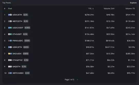

I need Uniswap liquidity pool addresses to develop my project. Can anyone tell me how to get the full list of these addresses?
3 Answers
There's a website for this, built and maintained by Uniswap Labs. It's info.uniswap.org:
Alternatively you might use the Uniswap V3 subgraph.

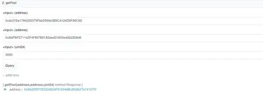

In case you want to get the pool address using etherscan here is how you can get it
- Get the addresses of the two tokens for which you want to get the pool address
In my case, I did a small transaction using uniswap UI on the goerli testnet and then coped the contract addresses for each token (click on Dai and weth and copy contract addresses)
https://goerli.etherscan.io/tx/0x57e299098f729aadc0a4ab8a3e8165ea62c13cfb5253247a1a3d4006026c2924
- Afterward, go on the uniswap v3 factory page on the etherscan, and under
read contractadd the addresses for each token. The third field represents the fee for the pool.
In my case, I used 3000 (which represents a 0.3% pool fee) and click on the query
https://goerli.etherscan.io/address/0x1f98431c8ad98523631ae4a59f267346ea31f984#readContract
NOTE: if the pool doesn't exist you will get 0x0000000000000000000000000000000000000000
