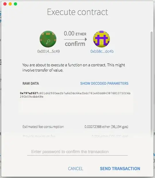

To confirm your multisig transaction, you will have to call
confirm("0xc801d42930eefb7a6d3dc64afbdc761e60dd843876810750f4b290b09cdbb68e")
Here is the screenshot from Ethereum Wallet showing the confirmation screen with the confirmation hash:
The first part of the byte string in the screen above is the confirm(...) method signature - this can be verified by executing the following statement in geth:
> web3.sha3("confirm(bytes32)").substring(0,10)
"0x797af627"

BokkyPooBah
  • 40,274
  • 123
  • 193
If, say, the contract is:
contract MultiSig { function confirm(uint256 arg1); }
Then in Browser Solidity, it will return you the ABI:
[{"constant":false,"inputs":[{"name":"arg1","type":"uint256"}],"name":"confirm","outputs":[],"payable":false,"type":"function"}]
Then in the browser console, you do:
> var contractAddress = "0x1234_WHEREVER_THE_CONTRACT_IS";
> var abi = '[{"constant":false,"inputs":[{"name":"arg1","type":"uint256"}],"name":"confirm","outputs":[],"payable":false,"type":"function"}]';
> var MultiSig = web3.eth.contract(abi);
> var multiSigInstance = MultiSig.at(contractAddress);
> var txData = multiSigInstance.confirm.getData(myArg1);
--> You get "0x1234_WHATEVER_DATA_TO_INCLUDE_IN_TX"
Then, if I understood your problem correctly, it is this txData that you give to your device.
