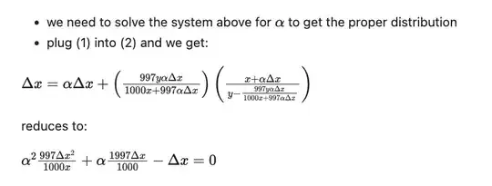

I have the math to this exactly worked out via my python package UniswapPy; the step-by-step walkthrough is in the jupyter notebook
Here are a few image clippings from it:
Then solve the quadratic for alpha; but you really have to read the notebook to get the full description
