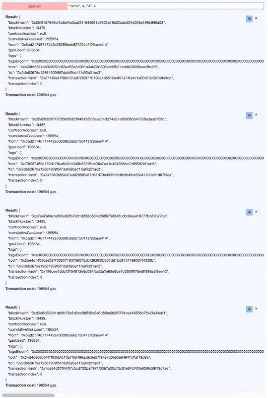

I called addItem(...) 4 times with the following parameters and the associated gas cost:
  • "item1", 1, "i1", 1 - 226,554
  • "item2", 2, "i2", 2 - 196,554
  • "item3", 3, "i3", 3 - 196,554
  • "item4", 4, "i4", 4 - 196,554
Following is the Browser Solidity screenshot: enter image description here

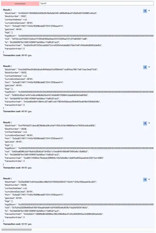

removeItem(...) Gas Cost Differences
I then called removeItem(...) 4 times with the following parameters and the associated gas cost:
  • "item1" - 48,181
  • "item2" - 48,181
  • "item3" - 48,181
  • "item4" - 33,181
