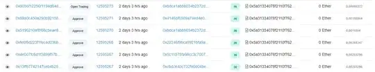

In summary: I would just like to get the name of the methods and to be able to make a display like etherscan.io, like this:
Thank you!
