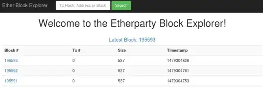

I am working on private Ethereum Network. I run Ethereum boot-node and Ethereum Block Explorer app ( https://github.com/etherparty/explorer (A lightweight ethereum block explorer.) ) on the main server.
Inside the main server where I run Ethereum node, at the browser I could connect into the Ethereum Block Explorer from localhost:8000:
But from an external node on the browser, when I try to connect from main server's ip address < ip-address >:8000 I have faced with the following error message. The main reason of this error message was "web3 is not connected"

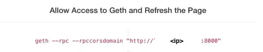

On the external node, if I run geth app on the background that is already connected to the private Ethereum network, it solves the problem.
[Q] On the external node without running the geth app on the background, is it possible for Ethereum Block Explorer to connect into the geth app that is already running on the main server? If yes, is there a secure approach as running geth with --rpcaddr="localhost" --rpccorsdomain="*" on the main server?

!!Please note that this solution only works if external node and the main server is in the same Network Domain!!
Insecure approach:
The problem was: how I start my RPC.
Run geth on the main server as follows:
> admin.startRPC("0.0.0.0", 8545, "*")
true
or
--rpc --rpcport 8545 --rpcaddr 0.0.0.0 --rpccorsdomain "*" --rpcapi "eth,web3"
Update explorer/app/app.js as follows:
    //var eth_node_url = 'http://localhost:8545'; //commented out.
    var eth_node_url = 'http://<ip-address of the main server>:8545';
    web3.setProvider(new web3.providers.HttpProvider(eth_node_url));
