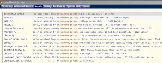

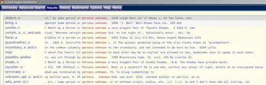

enter image description here enter image description here Whis is (the adjective?) unknown used after the noun phrase here?
