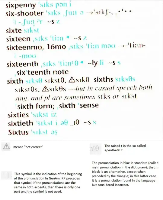

The Longman Pronunciation Dictionary (2000 ed.) stipulates that "sixth" is pronounced "/siksθ/" [at least in isolation] but also [as a minotity pronunciation] "/sikstθ/"; "/sikθ/" is considered to be an error. Similarly "sixths" is "/siksθs/"; "/sikstθs/ is acceptable while "/sikθs/" must be rejected as a possibility (for the time present, anyway). A note in this entry for "sixth" and "sixths" reveals that 'in casual speech, both sing. and pl. are "/siks/" or "/sikst/"'.

It must be understood that the accent that is the main concern of this dictionary is RP, GenAm being treated too but not as expertly. Words such as "stipulate" do not go further than the particular accent concerned: for instance, if you intend to remain within RP you have to use /hɔ:l/ for the pronunciation of "hall"; if now you think that /hɒ:l/ suits you better, you can choose this prononciation (and you have to use it if you want to have an American accent) but this is not a usual pronunciation in RP. The necessities expressed by the terms I use are no more prescriptivist than that: they are not used to discriminate within a given accent and impose one form rather than another in that accent but they merely indicate that for the given accent there is no other standard.
Unfortunately, I have no link to this dictionary, but I don't mind adding a numerization of that part of it showing these pronunciations.

    'stipulates', 'banned', 'have to'? Even the strongest prescriptivists/ESL teachers don't use authoritarian words like that. And copy editors at the New Yorker might use those terms but not about pronunciation. Also, can you give a link to Longman where they mention /sikstθ/ and /sikstθs/? I find it very hard to believe that those are alternatives that they print. – Mitch Apr 22 '20 at 21:26
    @Mitch I'll make an addition to my answer; that way I'll communicate more clearly what I can say. – LPH Apr 23 '20 at 12:29
  • Are you sure you can't get the link to Longman online? 2) Where is that screenshot taken from? I'd like to check the original source. 3) 'banned' is not a word even prescriptivists use (except maybe in some totalitarian governments and then it's a political action). 'not correct' is sufficient prescriptively, 'non-standard' or 'considered improper' for descriptivists.
  • – Mitch Apr 23 '20 at 13:43
  • @Mitch 1) Yes, I'm sure: I tried several times; but that doesn't mean someone else can't. There is a confusion here between "The Longman Pronunciation Dictionary", which is strictly a pronunciation dictionary, and the The Longman Dictionary of Contemporary English, which is online (as you found out) and is not a pronunciation dictionary. 2) This is not a screenshot but part of a numerization of a page from the paper version of this pronunciation dictionary (which I own (2000 ed.)). 3) I agree with you on that, "banned" is not quite idiomatic, it would probably be better to change it. – LPH Apr 23 '20 at 19:09
