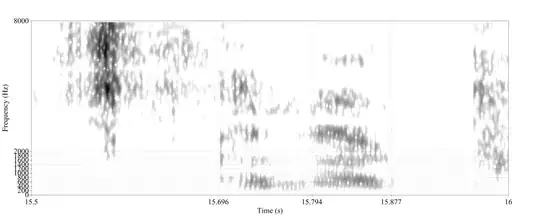

I'm going to show the acoustic signals that are on the tape. It's hard to be certain on this one because the normal cues that you'd look for are just very faint or hard to distinguish. I'd be surprised if a linguist comments decisively for the media about what the tape shows going strictly by the physical audio (they might infer using other techniques).
tl;dr you can't tell unless you're able to squint better than me. I can't see glottalization, but it wouldn't be expected anyways (it's normally a cue for coda [t], not [d]).
Below you'll see a spectrogram. This is gotten with the software Praat. I extracted the left channel and had Praat display a spectrogram using a window length of 5 ms and a dynamic range of 35.0 dB.
First, what are you seeing? The spectrogram shows acoustic energy by frequency, with darker spots corresponding to more energy. Between 15.696s and 15.877s is the phrase "and I" or "and I'd". Before that you'll see high frequency noise (sounds like a click or sucking sound). After that you see about 90 ms of silence, followed by the release of the p (noise in the range of the first four vocal formants).
There are three types of cues you can look at (maybe more).
  1. Formant transitions
  2. Presence/absence of glotallisation
  3. Stop closure duration
First, formant transitions. Focus on the syllable between 15.794s and 15.877s. You'll see two regions of periodic sound (regular pulses of energy) between around 400--800 Hz and 1400--1800 Hz. These are the first two formants (F1 and F2), and they are determined by the the shape of the oral cavity (created by jaw position and tongue shape). Comparing [a] and [i], F1 should be higher for [a], and F2 should be higher for [i]. So in the diphthong [ai], you are going to see F1 and F2 start out close, then F1 drops while F2 rises. Consonants also affect the shapes of the formants. In the Trump "big league" affair, it was clear that he was saying "big league" because velar consonants like [k] and [g] cause F2 and F3 to "pinch" together. Anyways, a labial consonant like [p] should cause all formants to drop. An alveolar consonant like [d] should cause F1 to drop, and F2 to become more central (close to where it would be for [a] or schwa). Since right before the disputed consonant (is he saying [dp] or [p]?) is [i], which is front and has a high F2, you would expect to see a drop in both F1 and F2 regardless of whether it was [d] or [p]. So I can't draw anything from formant transitions.
As for glottalization. That comes before [t] specifically, not [d] (in fact it makes [t] and [d] easier to tell apart). So we shouldn't expect glottalization. The longer pulse periods starting at 15.696s might be glottalization (he had paused). You don't see the pulses getting irregular as the contested consonant closure is formed, but you wouldn't expect them.
As for closure duration, 90 ms seems a bit long for a stop closure for someone who's speaking fast, so that'd be an argument in favor of [dp], but then again he might have paused for an instant to think what to say next, since he was speaking extemporaneously.

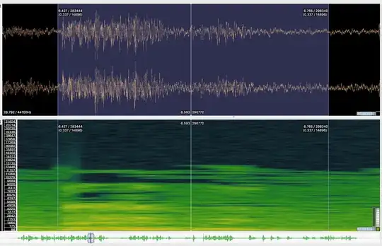

1. President Xi
Around 6 seconds in, President Trump says:
... President Xi ... I have a great relationship with him ...
waveform and spectrogram of quote 1
Sonic Visualizer session for this quote.

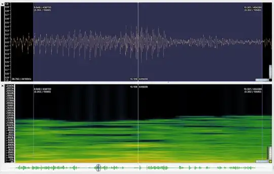

2. Prime Minister Abe
Around 10s in, President Trump says:
... As you know I have a great relationship with Prime Minister Abe ...
waveform and spectrogram of quote 2

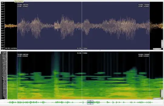

Around 16s in, President Trump says (this is the disputed quotation):
... and I['d?] probably have a very good relationship with Kim Jong Un ...
waveform and spectrogram of quote 3

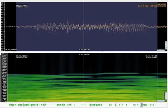

4. Other people
Around 25s in, President Trump says:
... I have relationships with people ...
waveform and spectrogram of quote 4
