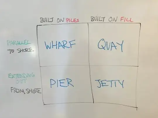

Here we see the different terminology for wharf, a pier, a jetty and a quay - which all depend on whether they are built on piles or fill; extending out from shore or parallel to shore.
Strangely missing from this is floating platforms - pontoons.
My question is: Are there different names for a pontoon if it is parallel or extending out from the shore?

    I'd guess that you can have a pontoon wharf and a pontoon pier, just like a pontoon bridge. Just a guess. – Drew Jun 11 '16 at 02:38
  • Good question about pontoons, but I disagree with your divisions for wharf, pier and jetty. Historically a pier could also be built as a solid structure (see here), and jetty can be defined as a wharf or landing pier. I've always thought of jetties as small piers, and generally built on piles. – Chappo Hasn't Forgotten Jun 11 '16 at 02:48
    Pontoons are just structural components. You can make what you like out of them. Does a brick have a different name on the front of the house vs the side of a house? You can look at Bellingham for modern terminology. – Phil Sweet Jun 11 '16 at 03:19
Pontoon refers to the floating temporary support—a component—not the full structure as with the others you mention. A pontoon does not require connection to land.
Key here is the means of placement as well as the configuration. Other structures you refer to are not moveable, per se.
Stan

A pontoon may be used as a component in a floating pier or floating wharf. A "pontoon", so far as I am familiar with it, is a single floating element which may be used to build a wharf, pier, or bridge (or which may exist on its own, as, say, a diving platform).
