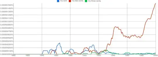

I've seen "$.02", "2¢", "just my two cents", etc, similar in meaning to IMHO, except usually appended to the main text.
As the Ngram shows, it is only "two cents" that is popular in this usage:
How does "two cents" express humility of opinion?
