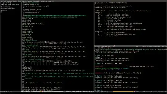

I use purpose-mode. This allows you to define a pretty robust environment.
Using elpy, pydoc, and neotree I have a pretty robust environment (in the sense that windows don't do strange things at errors). This can also work pretty well with gud-pdb for debugging.
