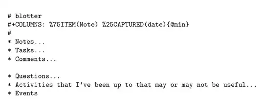

This does not address the specific issue of bookmarks in the PDF, but does address the general problem of converting buffers to PDF.
If you want to get a PDF "screenshot" of the buffer as you actually see it -- not showing hidden text -- then a good alternative is to htmlize the buffer, and convert the result from HTML to PDF. You could use this, for example, to build a PDF version of your Org Agenda. (Note that the ps-print-based answer from Kaushal Modi would show hidden buffer contents.)
recipe
M-x htmlize-buffer RET, C-x C-w buf.html RET; then run on the command line:
pandoc --from=html --to=latex --variable geometry="landscape" -o buf.pdf buf.html
example (screenshot)
