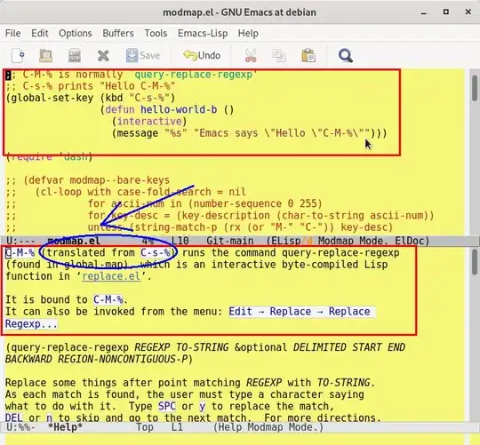

s key.;; Install some bindings on `super` keys for demo purposes.
;; M-x is `execute-extended-command'
;; s-x prints "Hello s-x"
(global-set-key (kbd "s-x")
(defun hello-world-a ()
(interactive)
(message "%s" "Emacs says "Hello s-x"")))
;; C-M-% is normally `query-replace-regexp'
;; C-s-% prints "Hello C-M-%"
(global-set-key (kbd "C-s-%")
(defun hello-world-b ()
(interactive)
(message "%s" "Emacs says "Hello "C-M-%"")))
M-x modmap-mode. You will see the following buffer popup, and it tells what the command just did.M-x, C-M-%. See what happens.s-x, C-s-%. See what happens.C-h k on above keys. See what Emacs reports.s-x modmap-mode, and try the above steps once more. See what happens.The M-x modmap-mode essentially "swaps" M- and s- keys.
