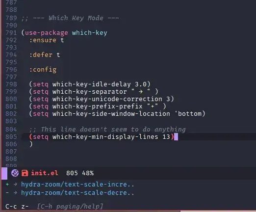

I'm using the which-key package and I checked the docs and it seems you can set the max height for the buffer with (setq which-key-frame-max-height 20) , but I can't seem to find a way to set the minimum height. I want to leave at least and empty line if the which key buffer is just a line height.
;; --- Which Key Mode ---
(use-package which-key :ensure t
:defer t
:config
(setq which-key-idle-delay 3.0) (setq which-key-separator " → " ) (setq which-key-unicode-correction 3) (setq which-key-prefix-prefix "+" ) (setq which-key-side-window-location 'bottom)
;; This line doesn't seem to do anything (setq which-key-min-display-lines 13)
Shows just two lines:

I have a set of key bindings that is one line. When I apply your minimum height of '13', the one line turns into 3 lines, justified left. Setting it to larger values seemed to have no further effect. Unclear to me what is meant by 'lines.'
It's 50-50 whether the lines would be above or below the listed key bindings. I opened an issue at GitHub. We'll see what happens.
